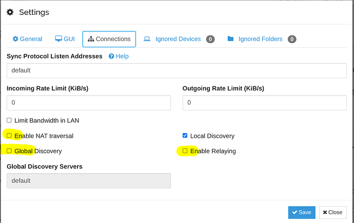

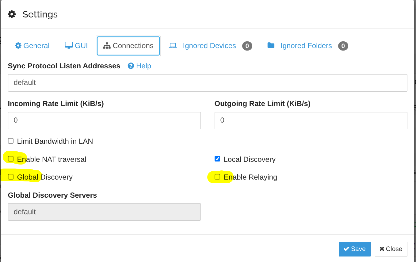

Turning off public relays
Noticed something interesting in syncthing logs:
2026-07-08 12:54:03 INF Joined relay (uri=relay://38.15.63.3:22067 log.pkg=relay/client)
2026-07-08 12:54:09 INF Detected NAT services (count=0 log.pkg=nat)
2026-07-08 12:54:18 INF Detected NAT type (uri=quic://0.0.0.0:22000 type="Port restricted NAT" log.pkg=connections)
2026-07-08 12:54:18 INF Resolved external address (uri=quic://0.0.0.0:22000 address=quic://66.219.178.167:22000 via=stun.voipbuster.com:3478 log.pkg=connections)
Turns out, Syncthing encrypts data when using external relays, but I only want data to sync on my LAN, so changed the following in my settings:
  • Uncheck “Global Discovery”
  • Uncheck “Enable Relaying”
  • Uncheck “Enable NAT traversal”
