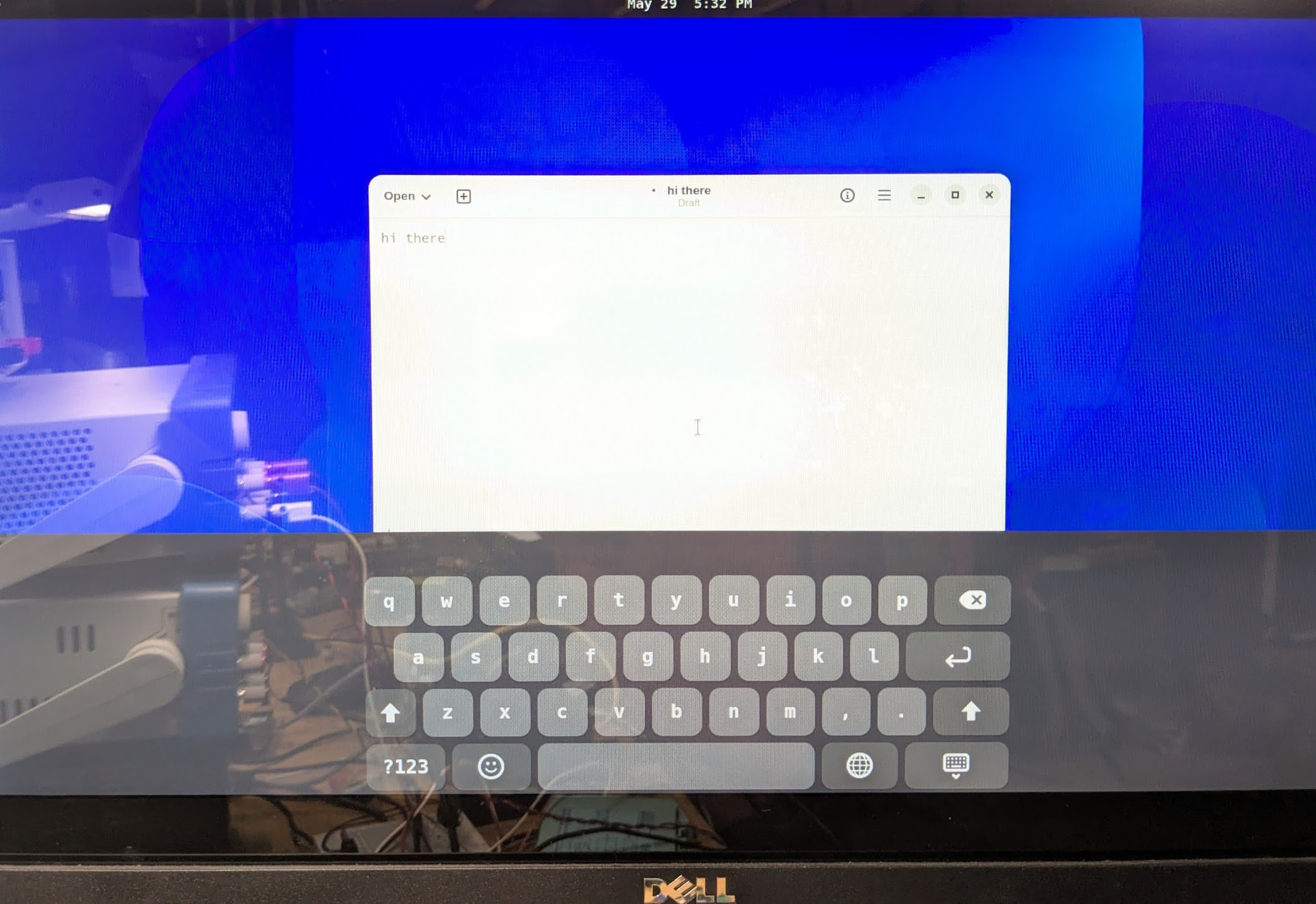

Gnome virtual keyboard
Recent versions of Gnome come with a pretty nice virtual keyboard:
