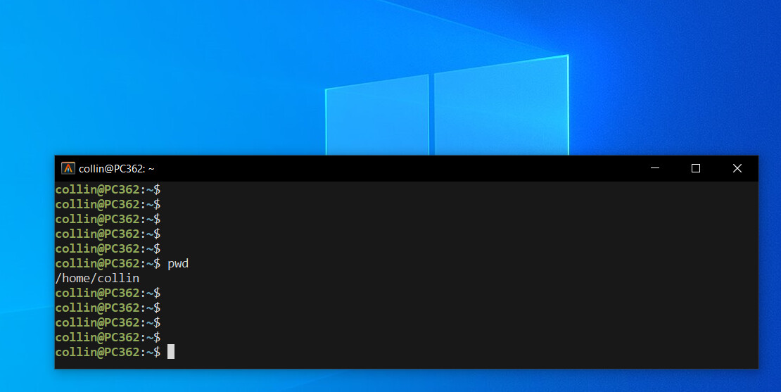

I recently tried Alacritty on Windows 10, with the shell set to WSL.
[terminal.shell]
program = "C:\\Windows\\System32\\wsl.exe"
args = ["~", "-d", "Ubuntu-24.04"]
It’s kind of neat to launch a terminal on Windows and have what feels like a full Linux environment without directly managing a VM.
