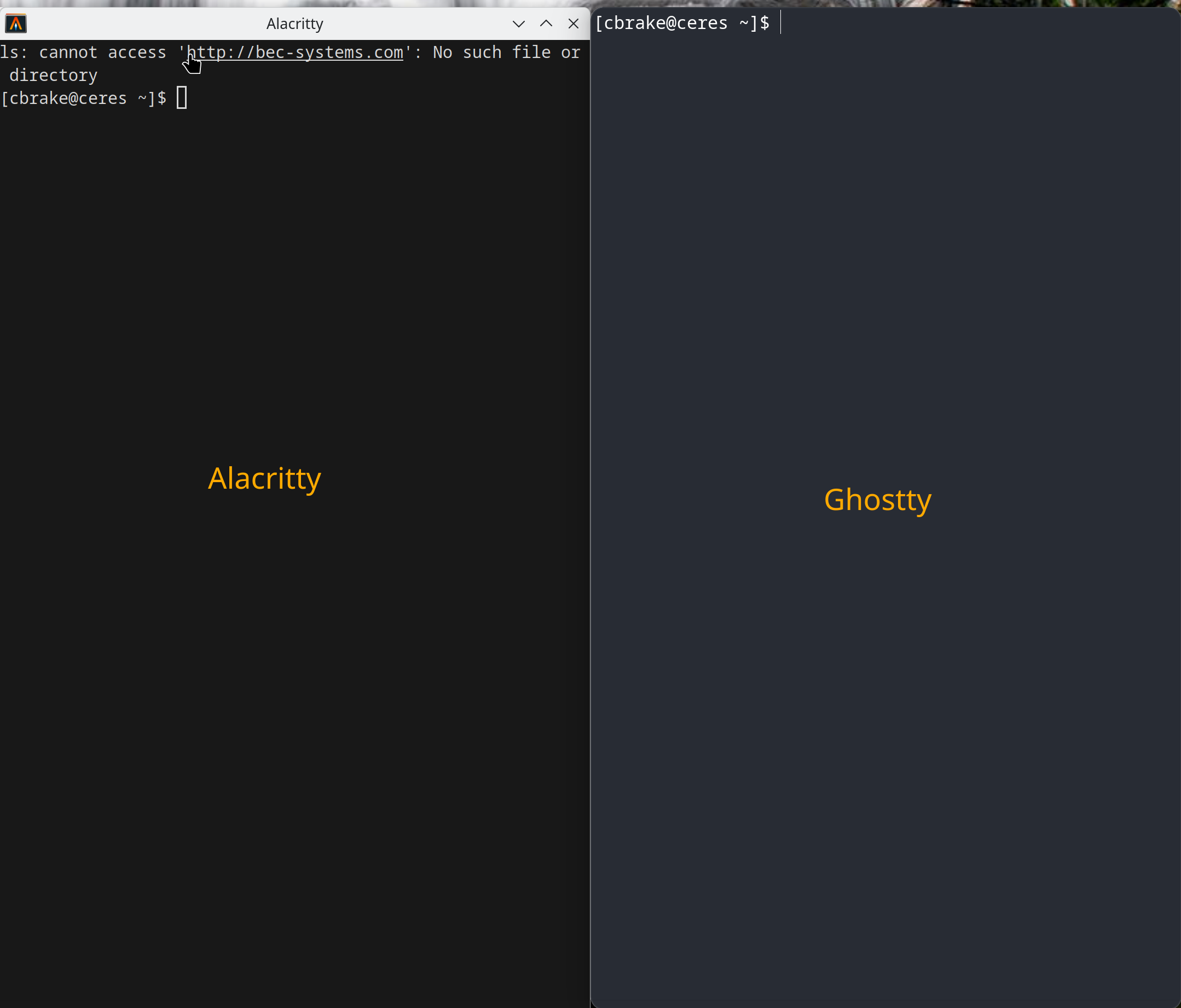

One thing I don’t like about Ghostty compared to Alacrity is the size of the bar at the top, which I don’t really need as I use Zellij instead of tabs in the terminal:
However, setting the following in ~/config/ghostty/config gets rid of it:
gtk-titlebar = false
The latest version of Ghostty completely gets rid of any bar at the top of the screen with the above config item – that is nice in that gives and extra line of text.

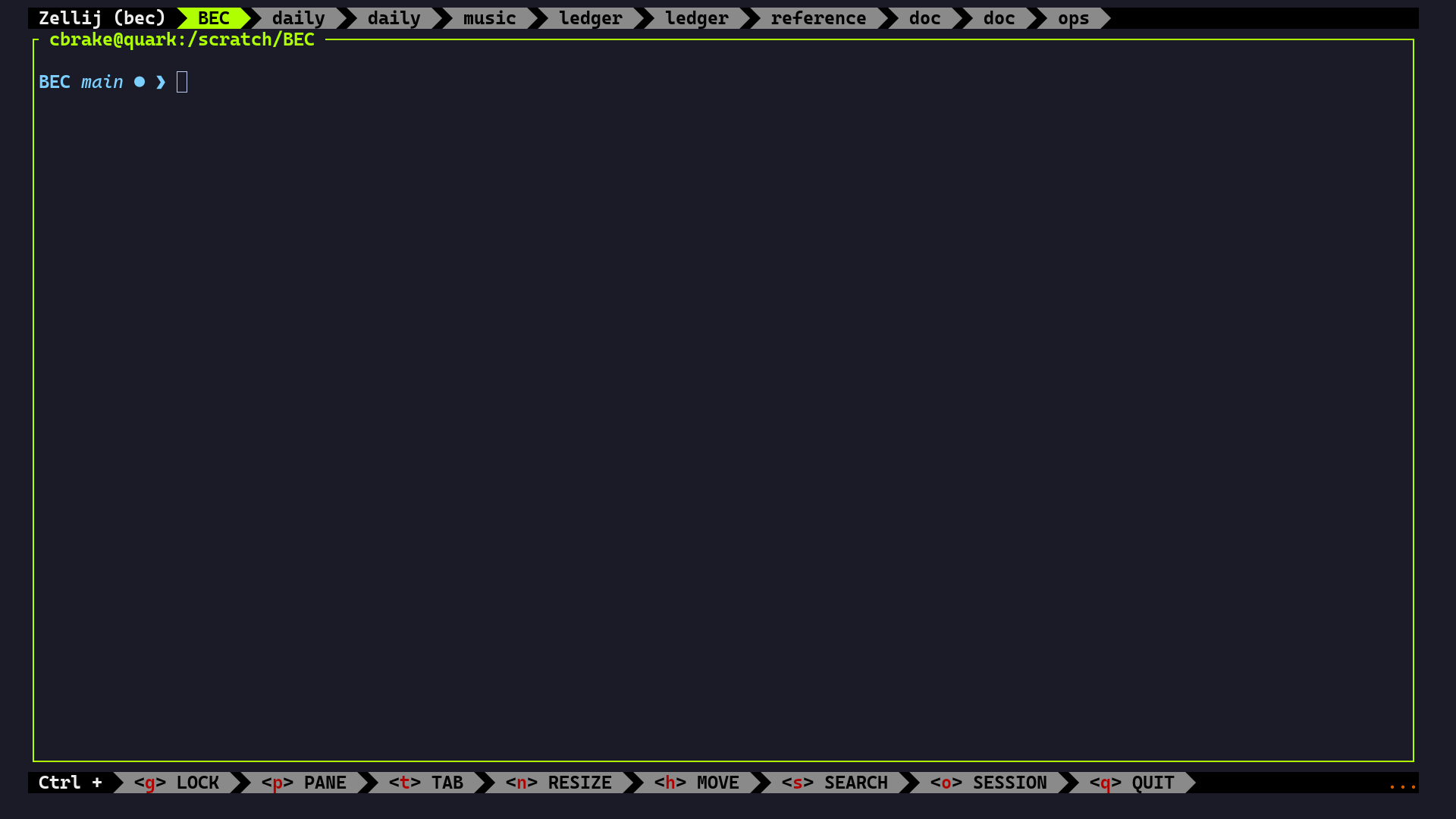

eliminating window decorations
This is my current config:
…/.config/ghostty ❯ more config
# Dynamic theme colors
config-file = ?"~/.config/omarchy/current/theme/ghostty.conf"
# Font
font-family = "CaskaydiaMono Nerd Font"
font-style = Regular
font-size = 9
# Window
window-padding-x = 14
window-padding-y = 4
confirm-close-surface=false
resize-overlay = never
window-decoration = none
gtk-tabs-location = hidden
adw-toolbar-style = flat
# Cursor styling
cursor-style = "block"
cursor-style-blink = false
shell-integration-features = no-cursor
# Keyboard bindings
keybind = f11=toggle_fullscreen
Looks pretty good:

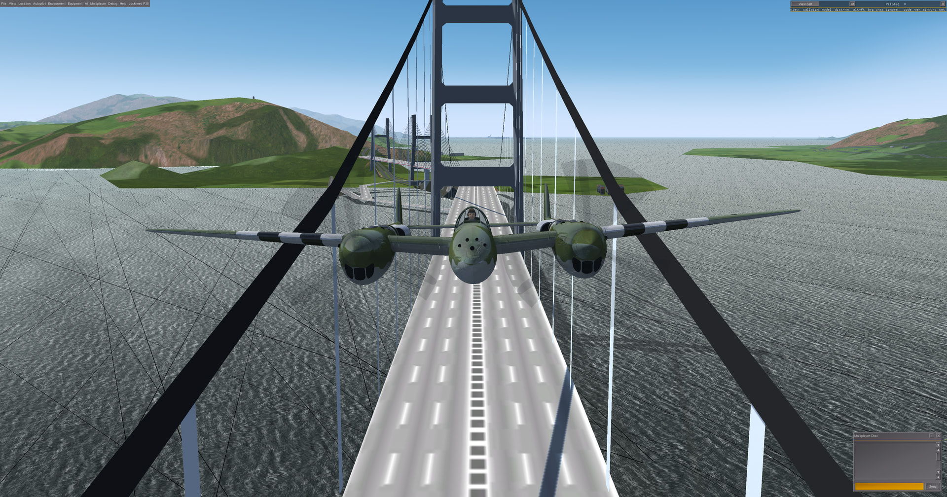

Ghostty supports dropping images into Claude Code
I dropped the following image into claude:
❯ [Image #1] what is this image?
  ⎿  [Image #1]
● This is a screenshot from FlightGear, the open-source flight simulator. Specifically:
  - Aircraft: A Lockheed P-38 Lightning — the WWII twin-boom, twin-engine fighter (visible in the title bar: "Lockheed P38"). You
   can see the iconic central nacelle with the pilot, flanked by the two engine booms.
  - Location: Flying through (or under) the Golden Gate Bridge in San Francisco — recognizable suspension towers and cabling,
  with the Marin Headlands to the left.
  - UI clues: The top menu bar (File, View, Location, Autopilot, Environment, Equipment, AI, Multiplayer, Debug, Help) is the
  standard FlightGear menu. The "Multiplayer Chat" panel in the lower right and the "Pilots: 0" counter indicate you're in (or
  set up for) a multiplayer session.
  Classic FlightGear stunt — buzzing the Golden Gate is something of a community tradition.
(This image is left over from when my son used to use this computer to play Flightgear)

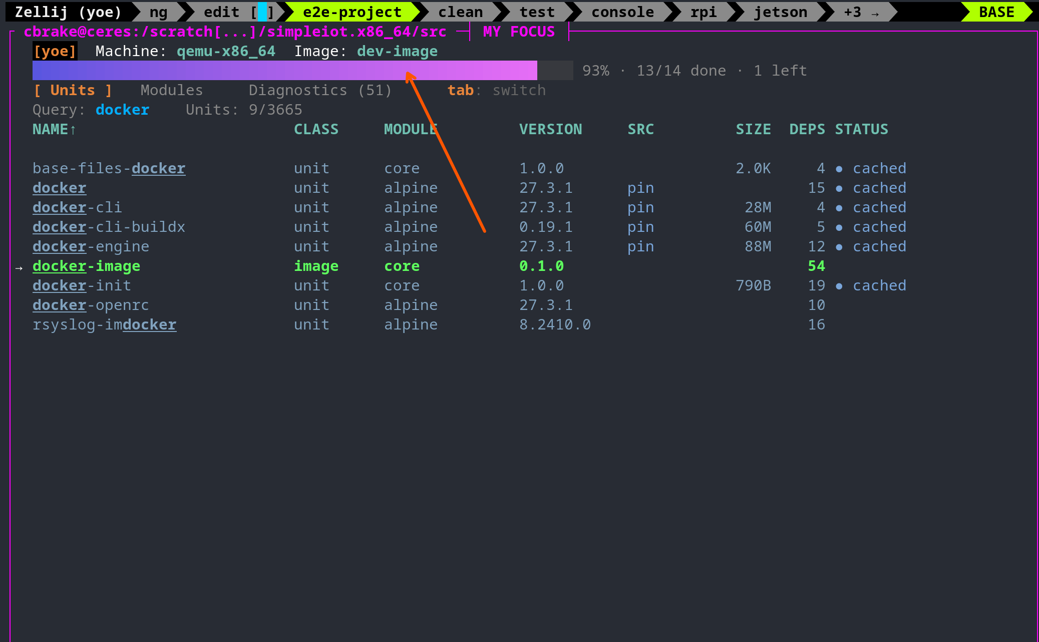

Ghostty also seems to give me smoother gradients on progress bars, so maybe more colors available:
