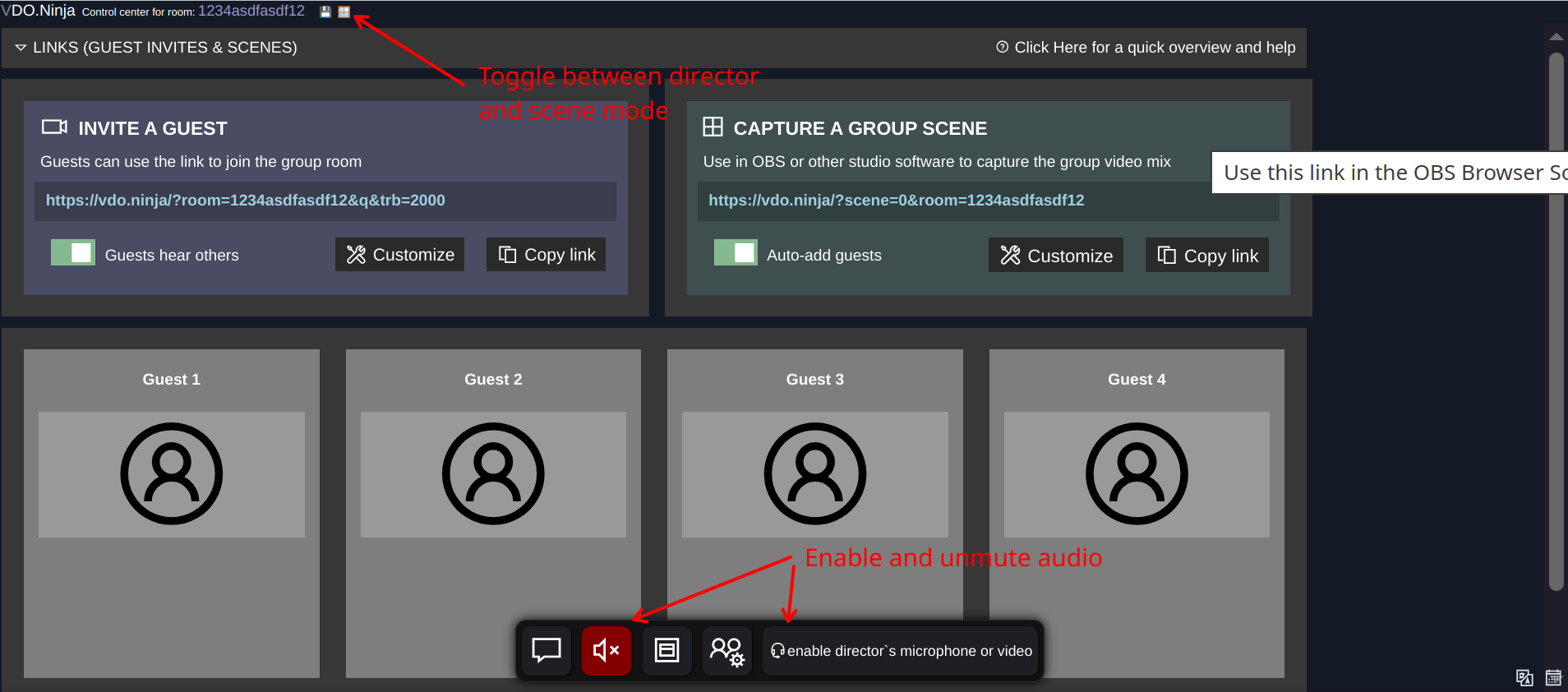

It took us a bit to figure out how to set it up. It has a scene mode and a director mode. You can toggle between the two modes by clicking the window looking icon at the top of the screen. You also need to enable your mic/video/speaker if you are a director and want to participate in the meeting. VDO is obviously set up to have a dedicated recording engineer, who is not participating in the call, manage the recording (maybe someday …).

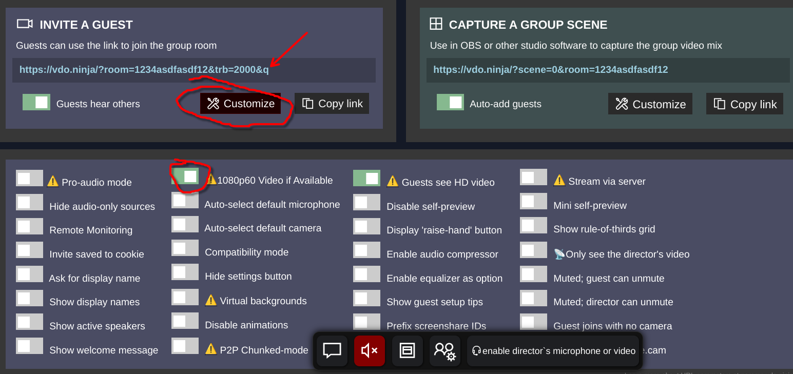

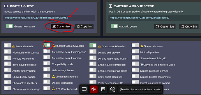

Initially, screensharing was a bit fuzzy, but after enabling 1080p60 video, that looked better. This simply adds a ‘q’ parameter to the URL.

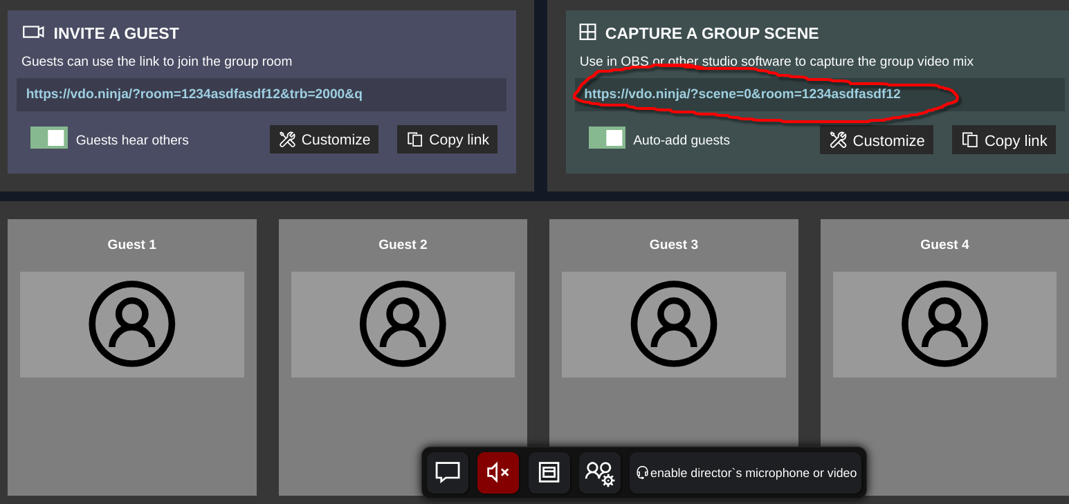

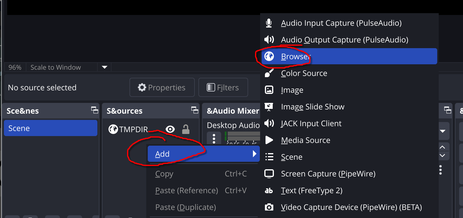

You can record directly to OBS using a rather interesting technique. You use the “Capture a group scene URL”:
In OBS, create a browser source, which starts a browser inside OBS and then captures the video/audio directly from that browser. The browser is another participant, so it receives audio directly from every participant. I use a laptop for calls, but capture the audio on a separate, more powerful workstation so my laptop fans don’t spin up during the call.

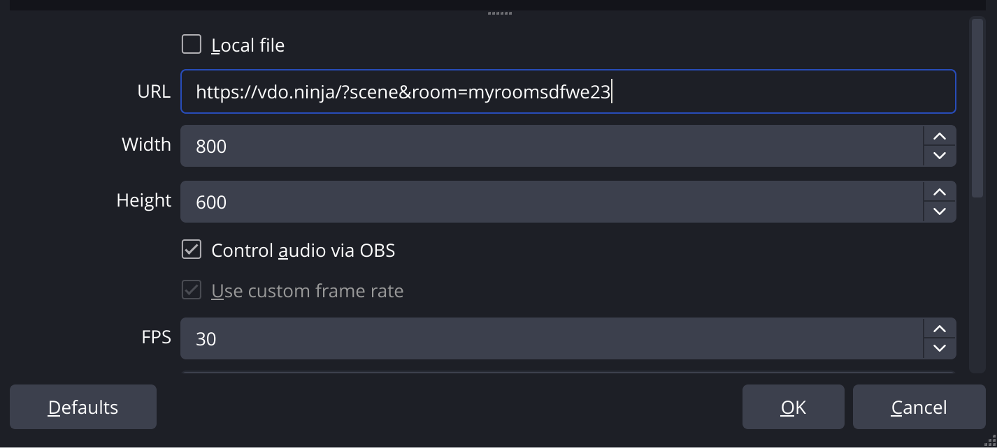

In the OBS browser source, populate the URL from VDO:

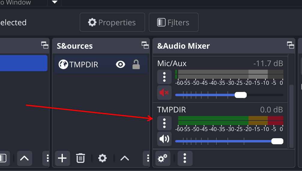

Select the Control audio via OBS and then scroll down in the Audio Mixer to see the levels:
VDO appears to adjust the audio levels automatically if not in pro mode – again, watch them in the OBS recording session.
