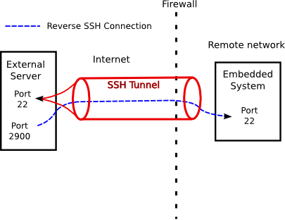

I’ve used ssh port forwarding for remote access to embedded systems for almost all of my projects, and it works well enough:
