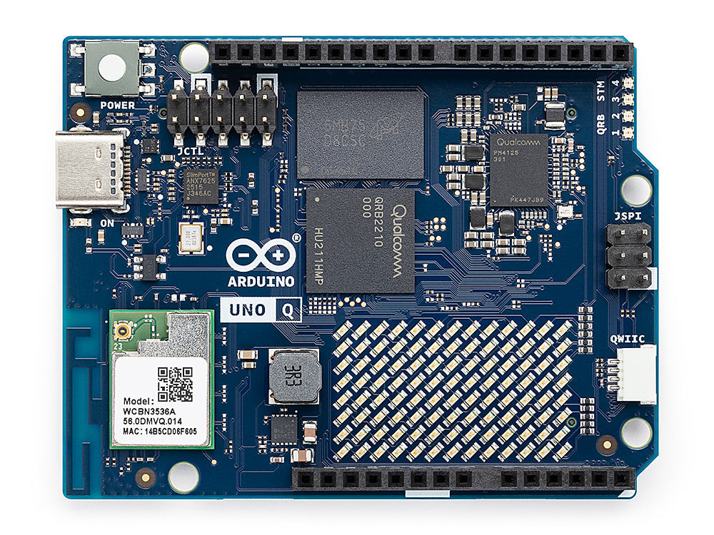

The Arduino UNO Q is a SBC with a Qualcomm QRB2210 and a low-power STM32U585 microcontroller in a classic UNO form factor, aimed at edge AI, robotics, and “apps” that span Linux and the MCU.

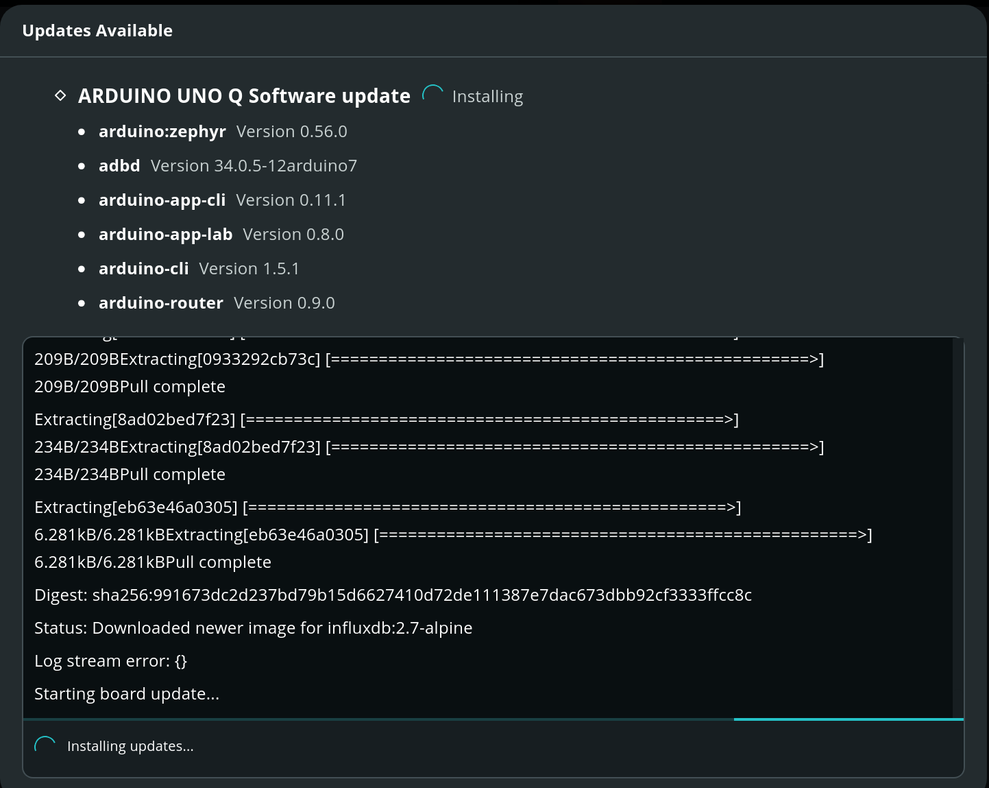

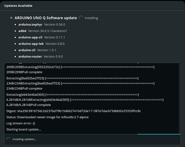

To configure the network, it is suggested to use the Arduino App Lab:
https://docs.arduino.cc/software/app-lab/
This apparently communicates with the board over USB and can be used to manage/configure it. It set the password, network, and then processed updates:
It’s interesting it was installing influxdb:2.7-alpine???

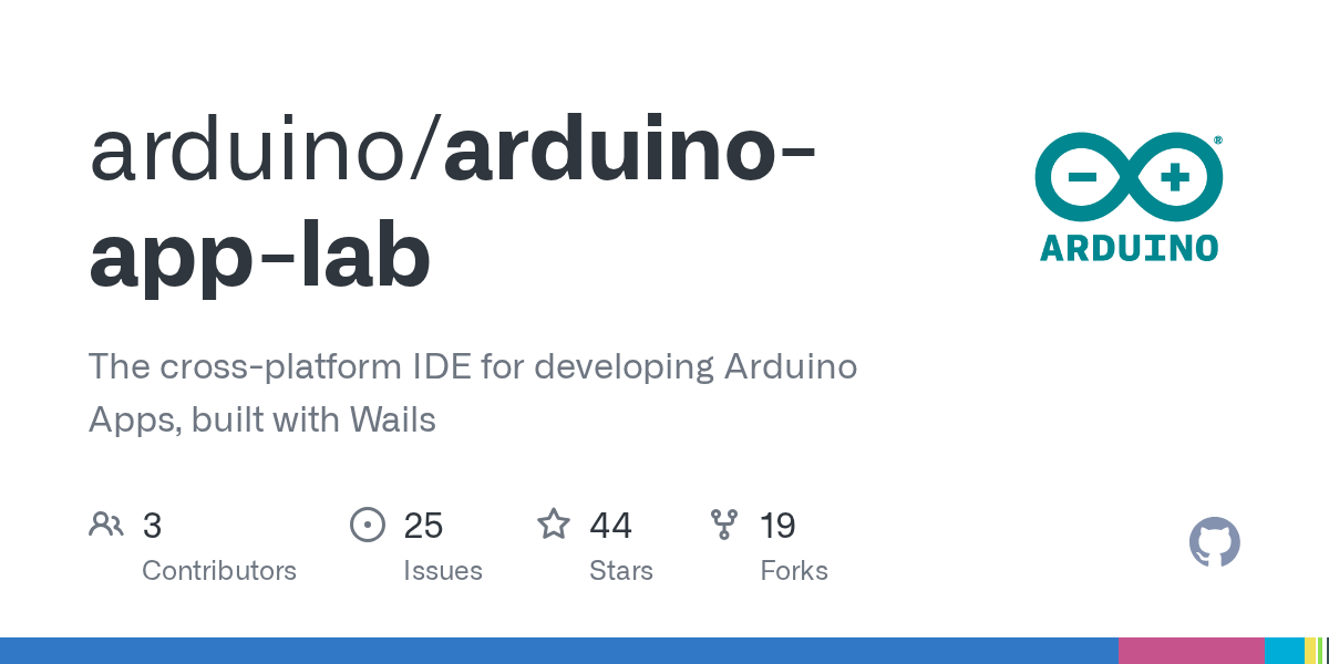

Arduino App Lab
Is a desktop app built with Go, Typescript, and Wails .
The cross-platform IDE for developing Arduino Apps, built with Wails
