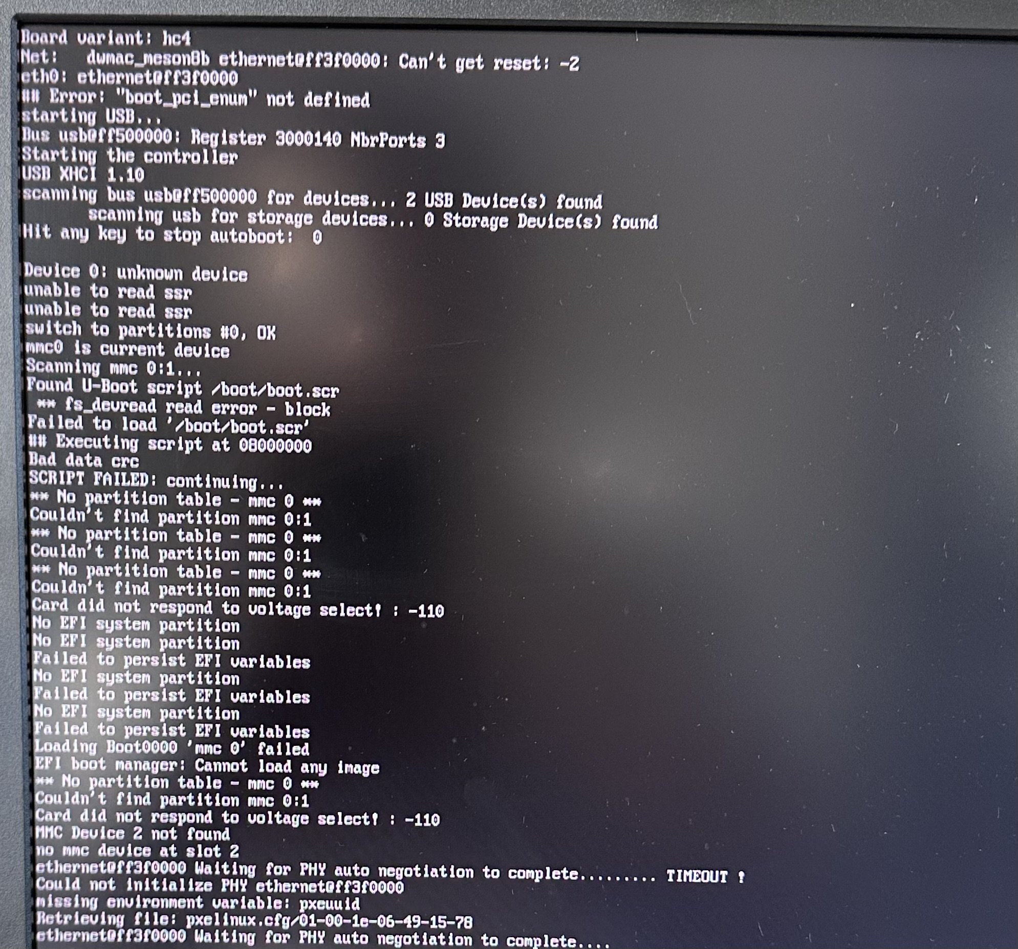

Switching to mainline BSP, works fine except that warm reboot does not work on all kind of uSD cards. cold power cycle works all the time. Its annoying but we are not the only one seeing it see
U-Boot 2026.01 (Jan 05 2026 - 20:49:22 +0000) odroid-c4/hc4
Model: Hardkernel ODROID-C4
SoC:   Amlogic Meson SM1 (S905X3) Revision 2b:c (10:2)
DRAM:  1 GiB (total 3.8 GiB)
Core:  401 devices, 30 uclasses, devicetree: separate
MMC:   mmc@ffe05000: 0, mmc@ffe07000: 1
Loading Environment from nowhere... OK
In:    usbkbd,serial
Out:   vidconsole,serial
Err:   vidconsole,serial
Board variant: c4
Net:   eth0: ethernet@ff3f0000
Hit any key to stop autoboot: 0
switch to partitions #0, OK
mmc0 is current device
Scanning mmc 0:1...
Found U-Boot script /boot.scr
747 bytes read in 1 ms (729.5 KiB/s)
## Executing script at 08000000
Error reading cluster
Failed to load 'meson-sm1-odroid-c4.dtb'
** No partition table - mmc 0 **
Couldn't find partition mmc 0:1
Can't set block device
Bad Linux ARM64 Image magic!
SCRIPT FAILED: continuing...
Card did not respond to voltage select! : -110
It works fine with hardkernel fork of u-boot
A fix is to get a known working uSD card e.g. SDXC UHS-I C10 V30 U3 A2
I ordered - Amazon.com: Lexar 32GB Micro SD Card 3 Pack, microSDHC UHS-I Flash Memory Card with Adapter - Up to 100MB/s, U1, Class10, V10, A1, High Speed TF Card (3 microSD Cards + 1 Adapter) : Electronics
and they seem to be working ok for warm reboot.
