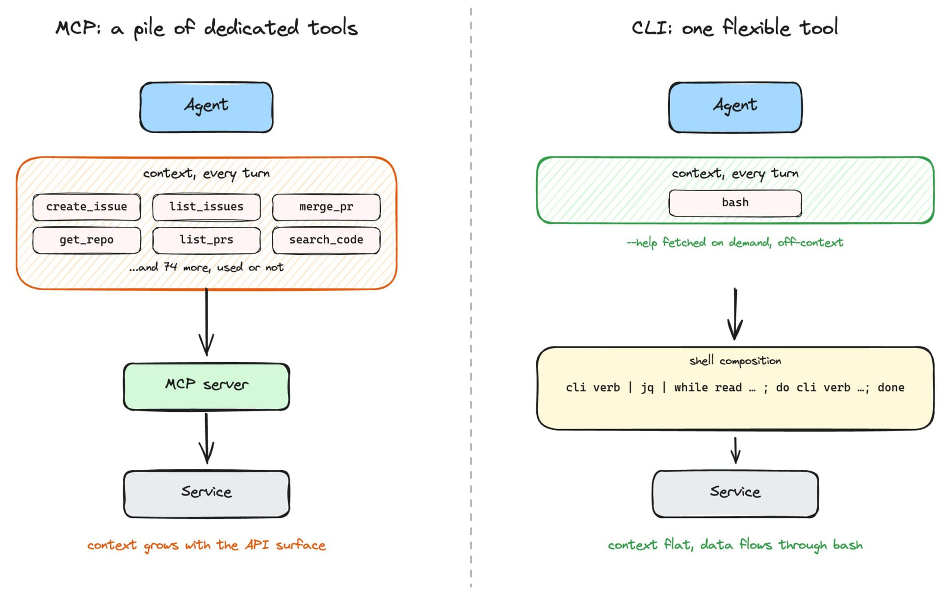

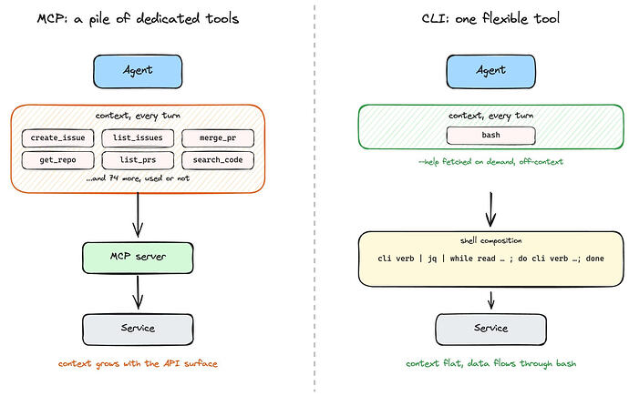

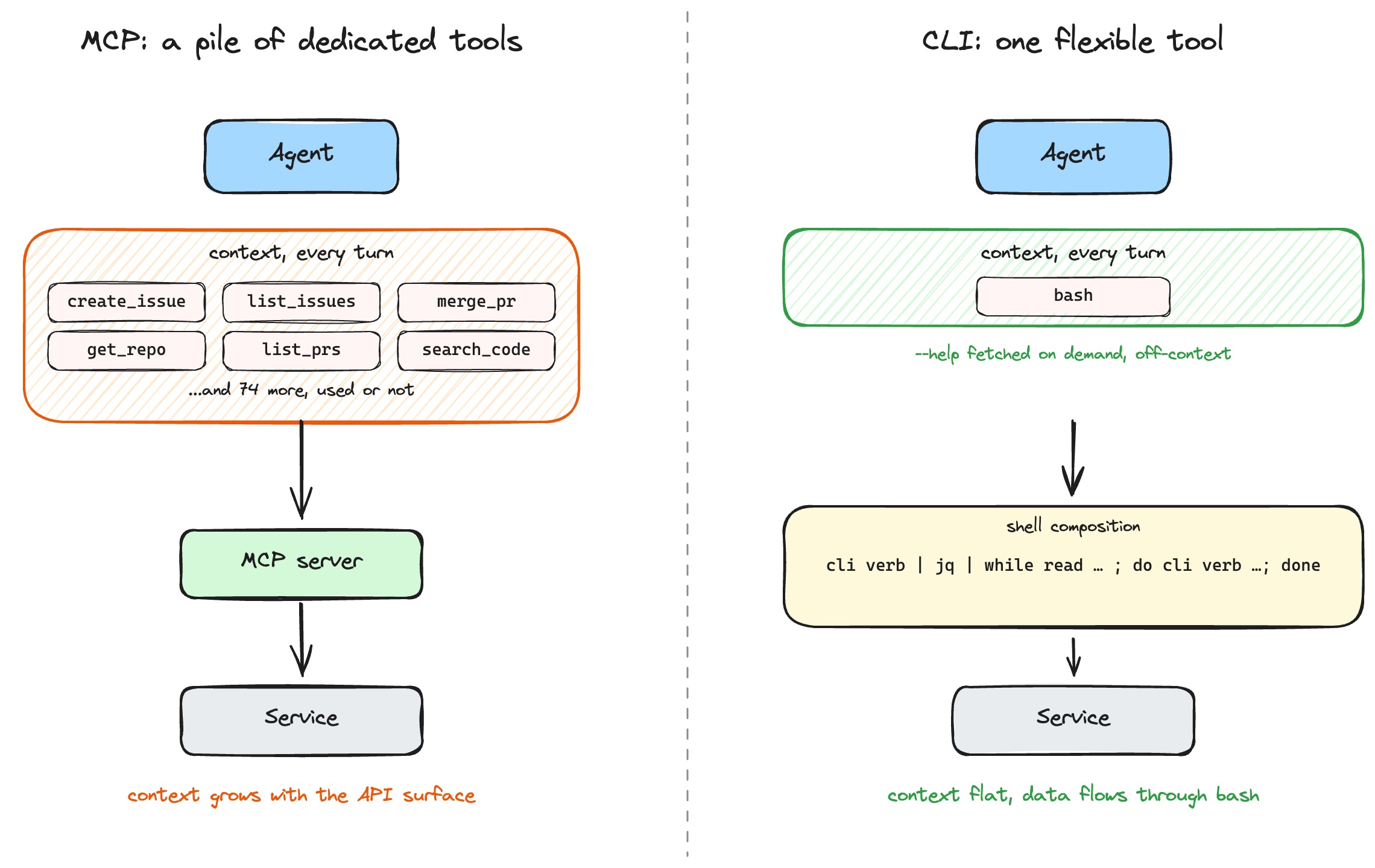

Peter Steinberger on MCP vs CLI
The thesis is short: MCP design usually wraps each service as a pile of dedicated tools; a CLI hands the agent one really flexible tool. With today’s models, the flexible tool wins.
