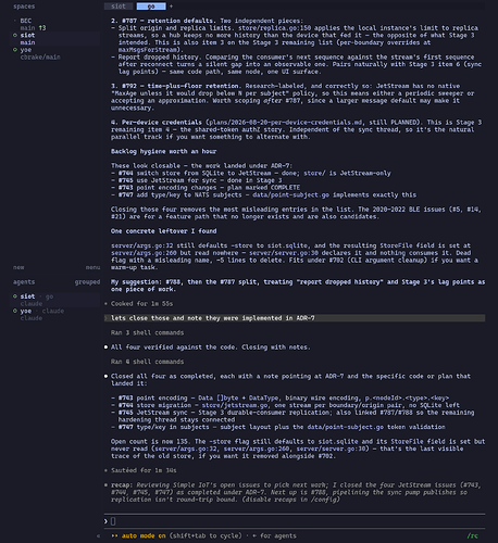

Screenshot:

A big difference from Zellij is that each herdr terminal on the same session runs in lockstep. With Zellij, I would often have a one tab open in one terminal and another tab in another terminal, which is very useful.
The solution right now is to start different sessions, which seems kind of clunky.
