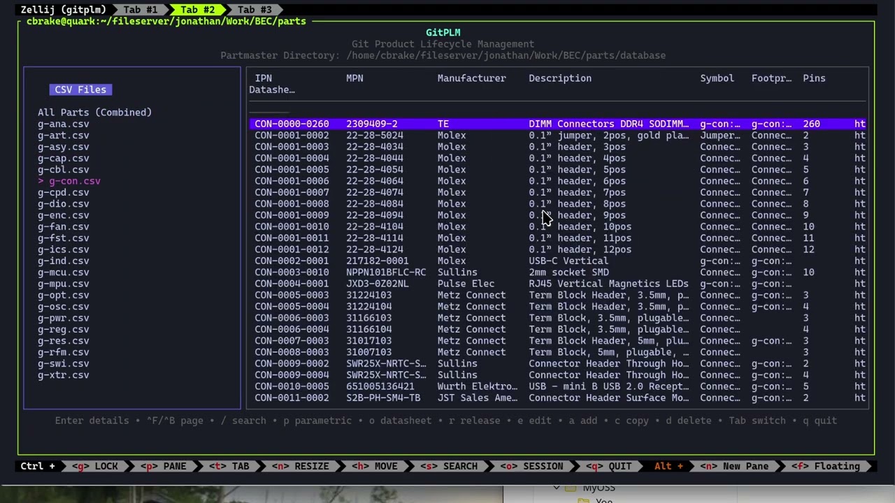

GitPLM Parts KiCad Database Library
GitPLM now supports KiCad HTTP API
This is now the preferred way to connect KiCad to the GitPLM library:
The GitPLM parts library now has a Claude Skill to add new parts
It seems to be working pretty well!
Video of the above feature:

In the v0.10.0 release.
I really like the interactive BOM, which is generated from the PCB file. I’ve added some examples for generating that.
