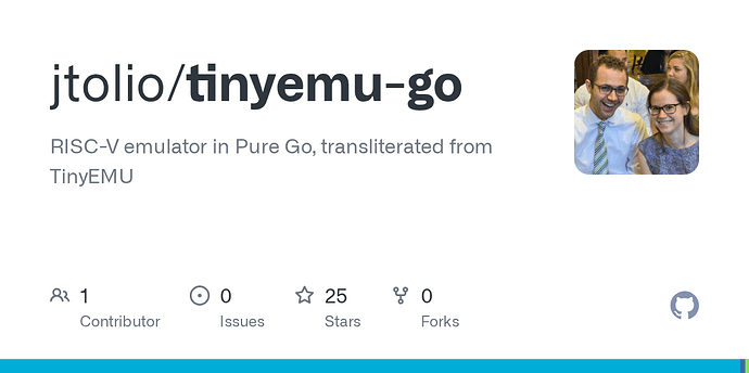

GitHub - jtolio/tinyemu-go: RISC-V emulator in Pure Go, transliterated from
And the experience building it with Claude Code:
I think software developers are going to continue to be gainfully employed for a long time if we can’t figure out how to encourage LLMs to prioritize simplicity.
The last 20% of a complex project is so friggin hard with Claude.
Lessons learned
First off, this Go library exists and works now, so Claude did something! It built a thing that didn’t exist that I wanted! So, that’s certainly the bottom line here. It’s tough to overstate this point.
But to also complain, this was an exercise in frustration in new and exciting ways. After letting this go a few weeks, I have found a codebase that ticks many boxes (good code coverage, many unit tests, lots of comments and documentation), but seems like it’s been developed by multiple separate raccoons in a trench coat and clearly not a person with one cohesive vision (Mo Bitar found the same thing). Maybe this would be less frustrating now that my expectations are more accurately calibrated. So perhaps this blog post can help you calibrate your expectations.
