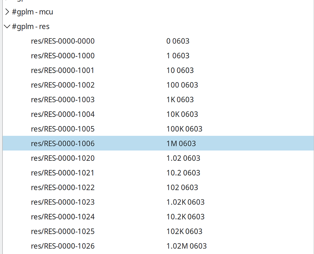

Example of using this plugin to generate KiCad library parts:
