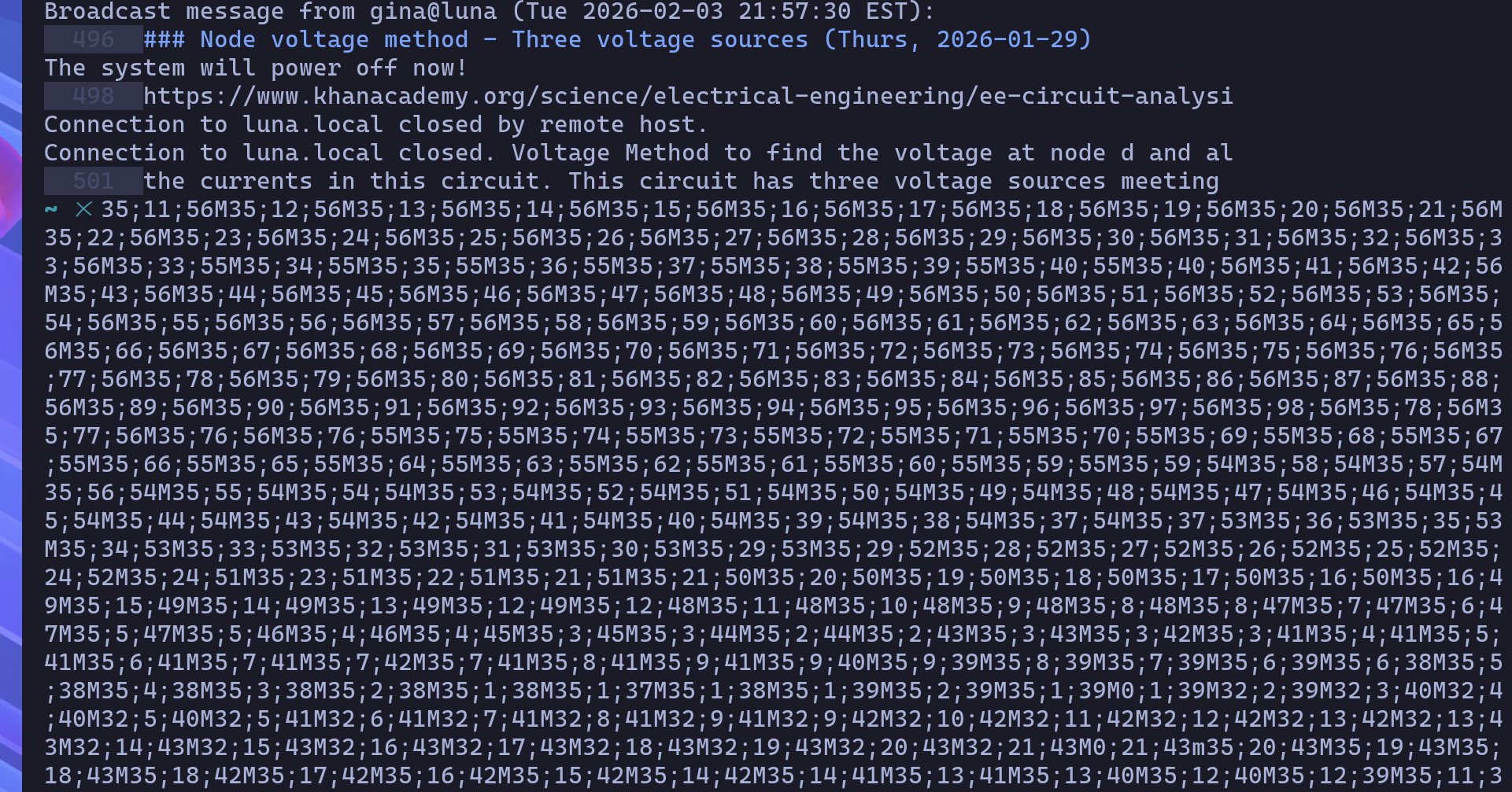

At times, with the Alacritty + Zellij stack, I’ll get strange escape codes in the terminal.
Example below:
I noticed that any time I scrolled the mouse wheel, I would see more codes.
Perplexity thinks this is due to mouse and other escape codes leaking in:
The “random non-ASCII characters” appearing in your terminal are almost certainly raw ANSI escape sequences—specifically mouse reporting or focus event sequences—that are leaking into the standard input of your shell instead of being intercepted by Zellij or the running application.
This typically happens when there is a mismatch between the terminal emulator (Alacritty) and the multiplexer (Zellij) regarding who handles these events, or when a sequence is fragmented (common over SSH).
It seems to happen more when running sessions over SSH:
If you are running Zellij over SSH, network packet fragmentation can split an escape sequence into two parts. The first part might be consumed, but the second part arrives purely as text, appearing as random characters.
A reset command will often fix things.
One thing that puzzles me is that once it starts, the terminal seems to get into a mode where the problem continues, and the system needs to be reset.
After that, subsequent escape sequences are still being parsed , but under the new charset/mode or from a misaligned parser state, so they look wrong on screen and keypresses produce garbage until you run reset or stty sane to reinitialize the tty and the emulator state.
