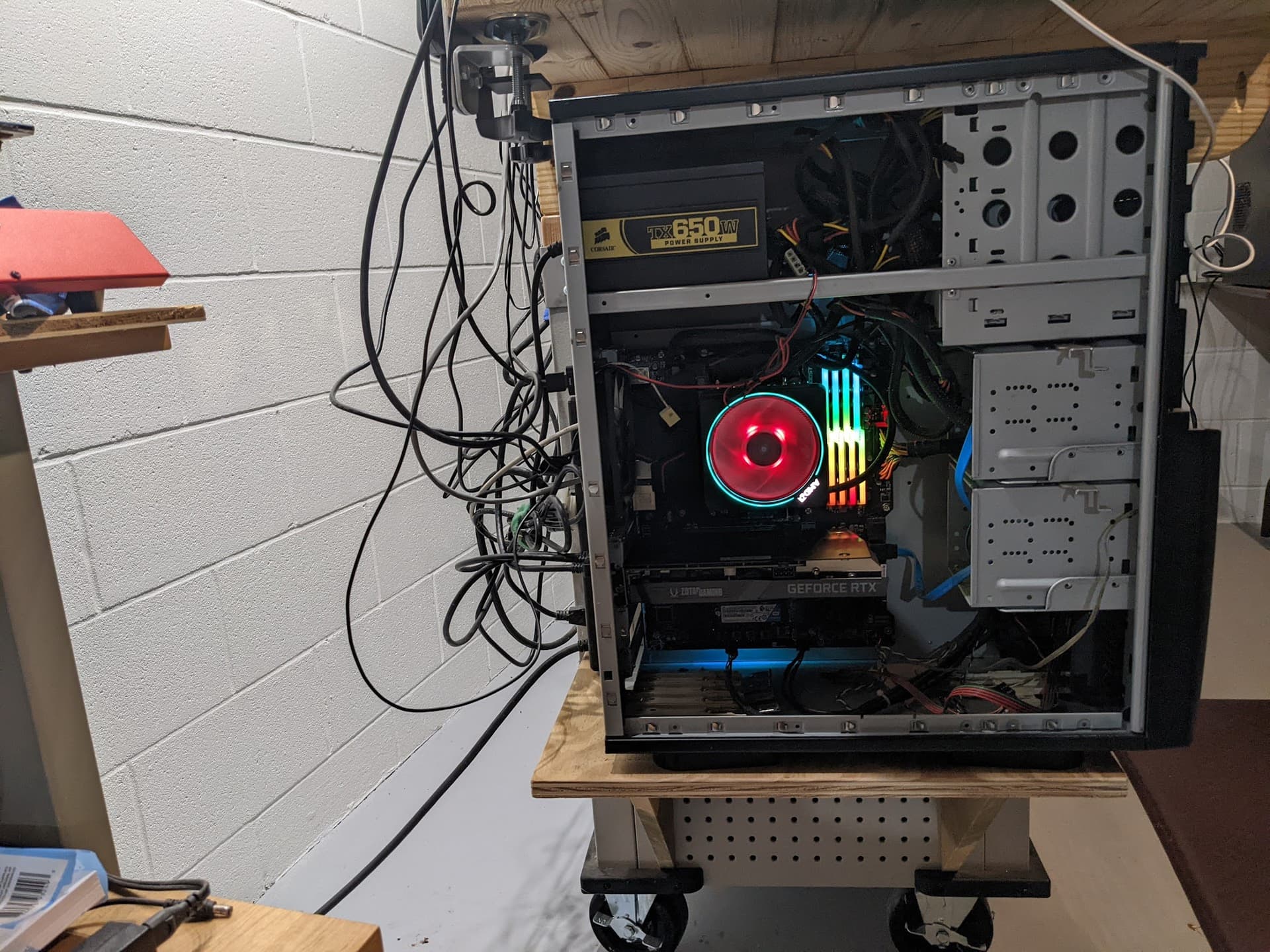

I’m currently running a 4 year old AMD Ryzen 3900X (12-core) with 64GB of RAM – currently does everything I need. I have re-used the same two ATX cases for 19 years, so it has been nice to not have to buy new cases with every computer.
I don’t keep up with specs – I usually just get what is current and replace everything except the power supply. If you only upgrade every 5 years or so, then everything is usually different, but perhaps the curve is leveling out and it will be more practical to re-use a motherboard over several generations of processors.
I currently like MSI for laptops and motherboards.
Building workstations from parts has worked very well – things typically go together with no problems and I can typically build a decent workstation for $1000 or so if the power supply and case can be reused. (inflation has likely kicked this up a bit in the last couple of years.) Computer parts are aimed at gamers, so they tend to be of fairly high quality.
