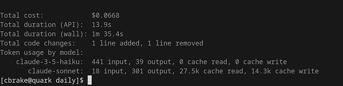

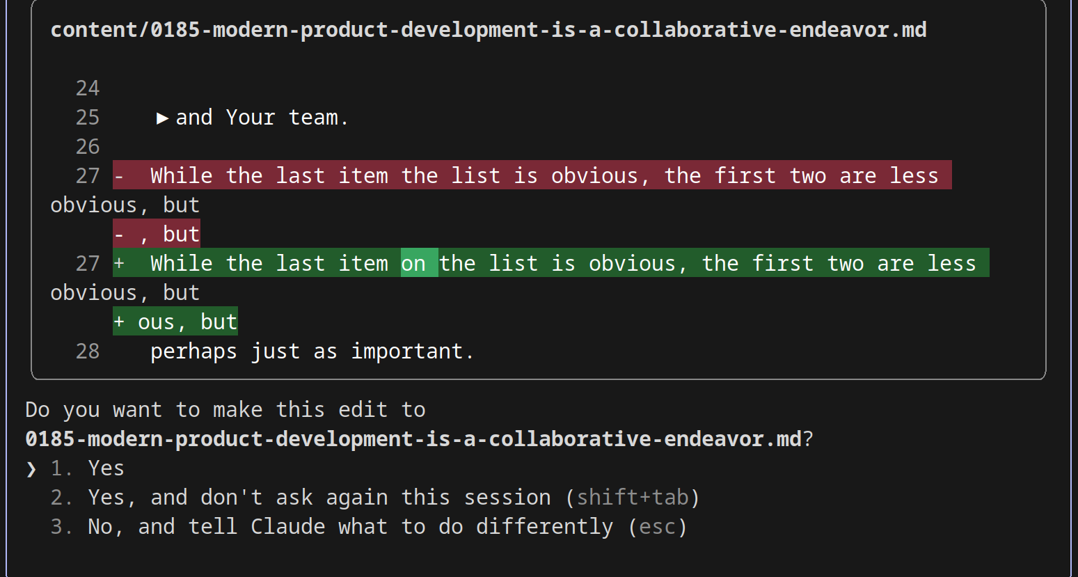

Claude Code for proofreading
I’m now using Claude Code to proofread some of my writing:
claude "proofread and correct file: content/some-blog-post.md"
Costs about $0.06 or so to do this using a basic API plan.
Claude proofreading seems like a nice balance – it seems to catch the obvious spelling and grammar errors, but is not quite as overbearing as Grammarly.

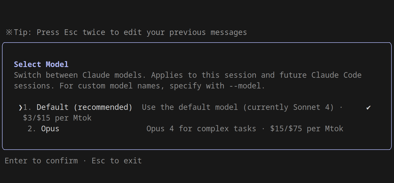

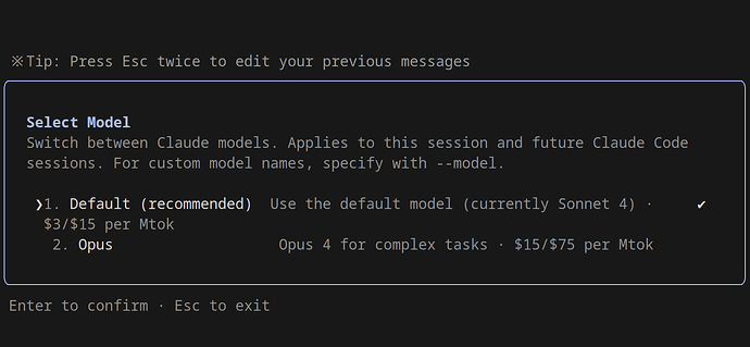

Selecting the model
You can type /model to select the Claude model:
Claude models are named after poems, where the names reflect the length of the poem:
  • Opus (most powerful)
  • Sonnet (balances capability and efficiency)
  • Haiku (optimized for speed and affordability)

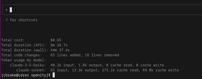

It is interesting in the above proofreading example, it appears Claude code uses a mixture of models for different tasks.

Coding Zephyr
Experimenting with using Claude code to add some custom shell commands and create a debugging stepping through a state machine. It needed some correction, but 30 or so states, it probably save some time typing. Interestingly, it did not use the Opus module, so I might manually switch that that next time:

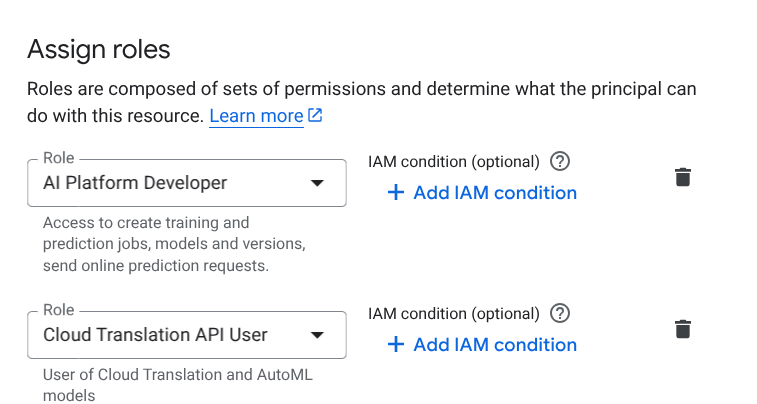

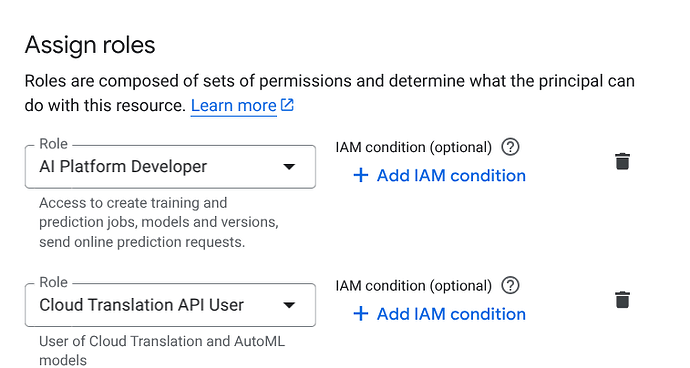

I had a little personal side project where I needed to OCR a bunch of faded typewritten scanned pages from PDF and translate them from German to English. Google lens was the only tool I found that could do the OCR effectively on the faded documents. I then wondered – does Google have an an API for Lens? Sure enough: Google Cloud Vision API.
The also have a translation API: Google Cloud Translate API.
I asked Claude to generate a program in Go that takes a directory of images, OCR’s them using the vision API, and then translates them. It took Claude about 10m to write the program and debug the compile errors. I then needed to set up a credentials file – setting up GCP or AWS AIM is not my idea of a good time, so I asked Claude to use gcloud in my terminal and set up an AIM profile – success, it created a credentials file that worked:

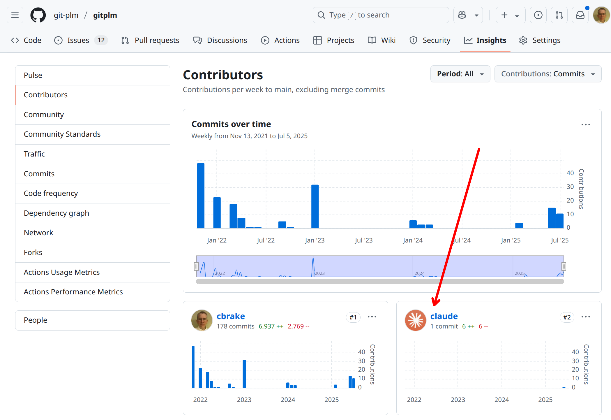

what happens when you have Claude commit your code:
Perhaps this is the most honest …

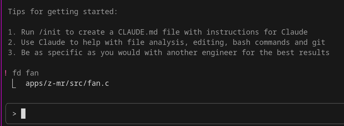

Running shell commands in Claude Code
Prefix with !. Example:
