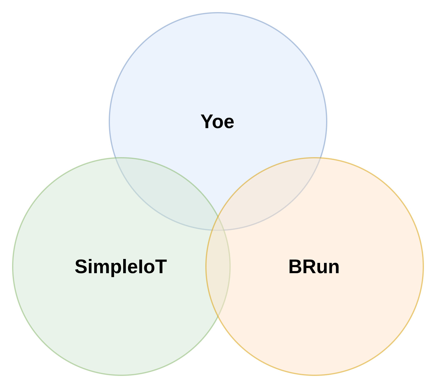

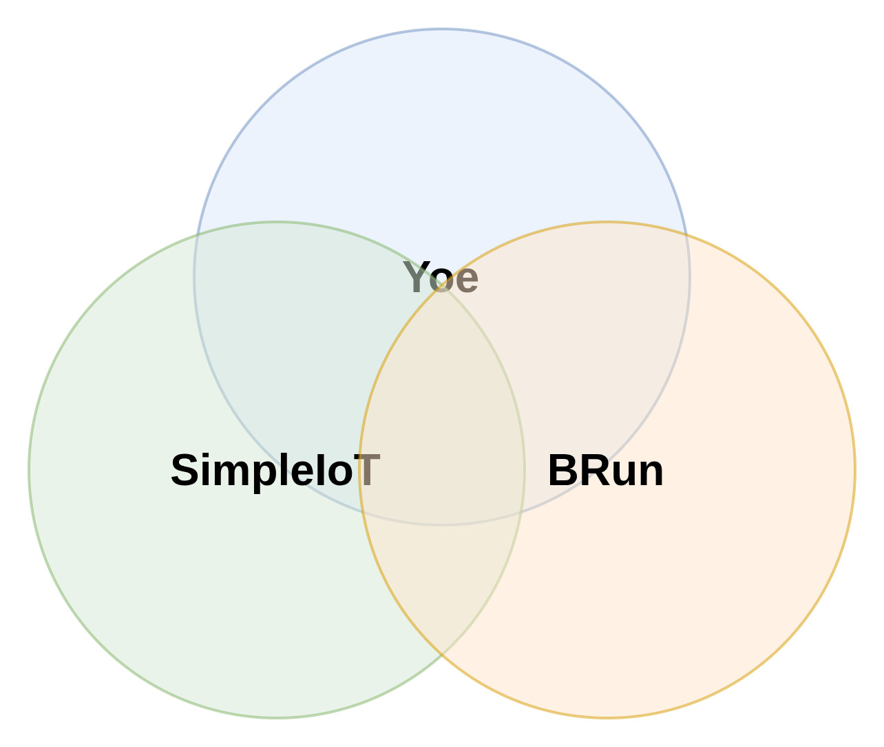

create a draw.io file “test.drawio” that has a venn diagram with three circles: Yoe, SimpleIoT, and BRun
The result:
can you adjust the circles so they overlap a little more?
Not, perfect, but it is doing what I ask it to do.

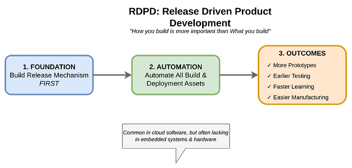

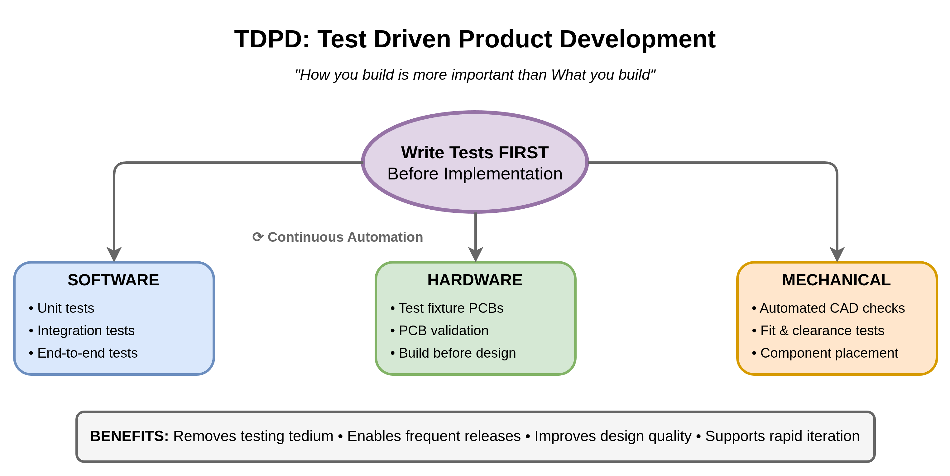

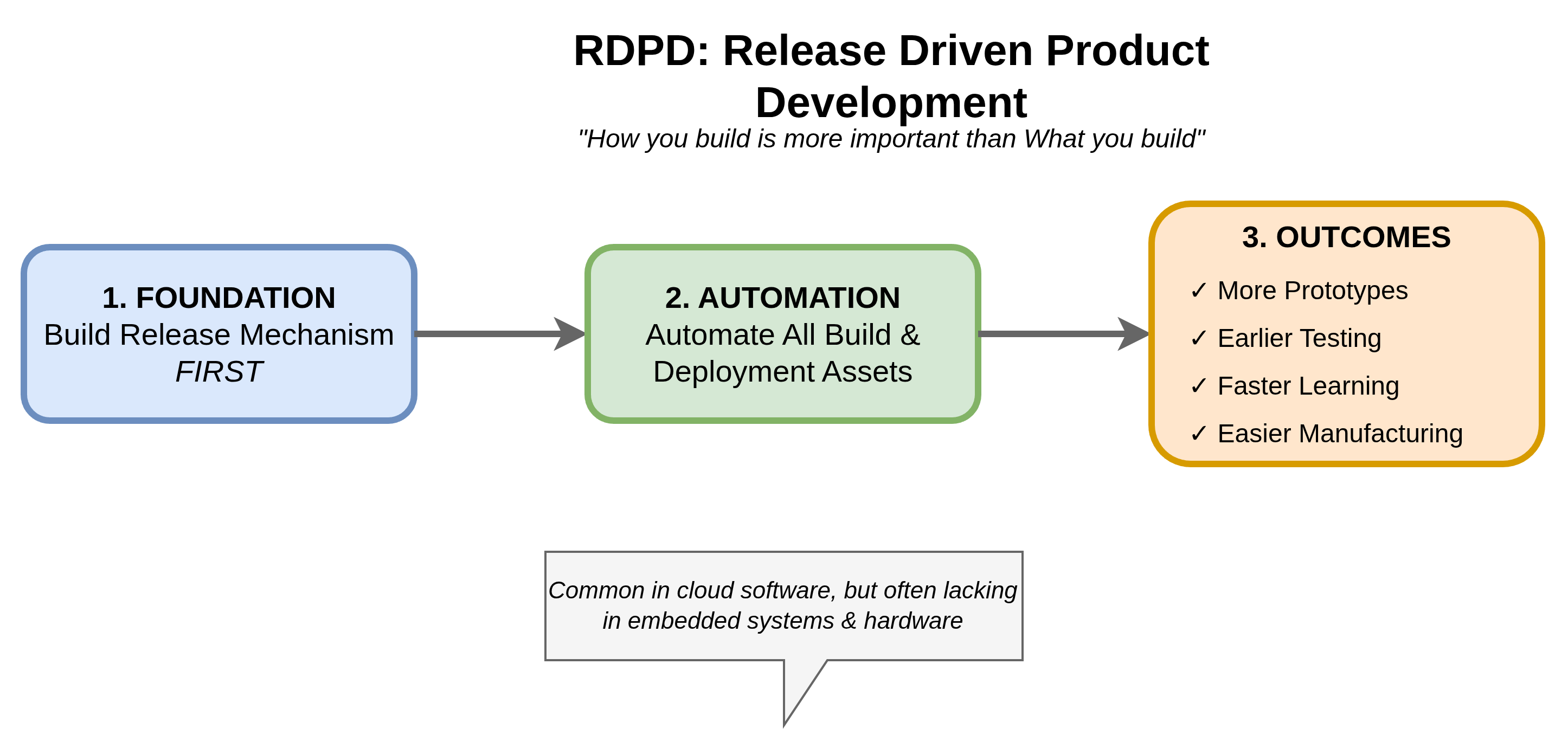

can you create a diagram for this post? 🚀 RDPD - Release Driven Product Development | Platform Thinking
The result:
This is impressive, and again illustrates why command-line tools, local files, and open file formats are the future.

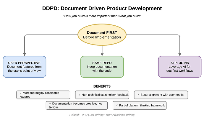

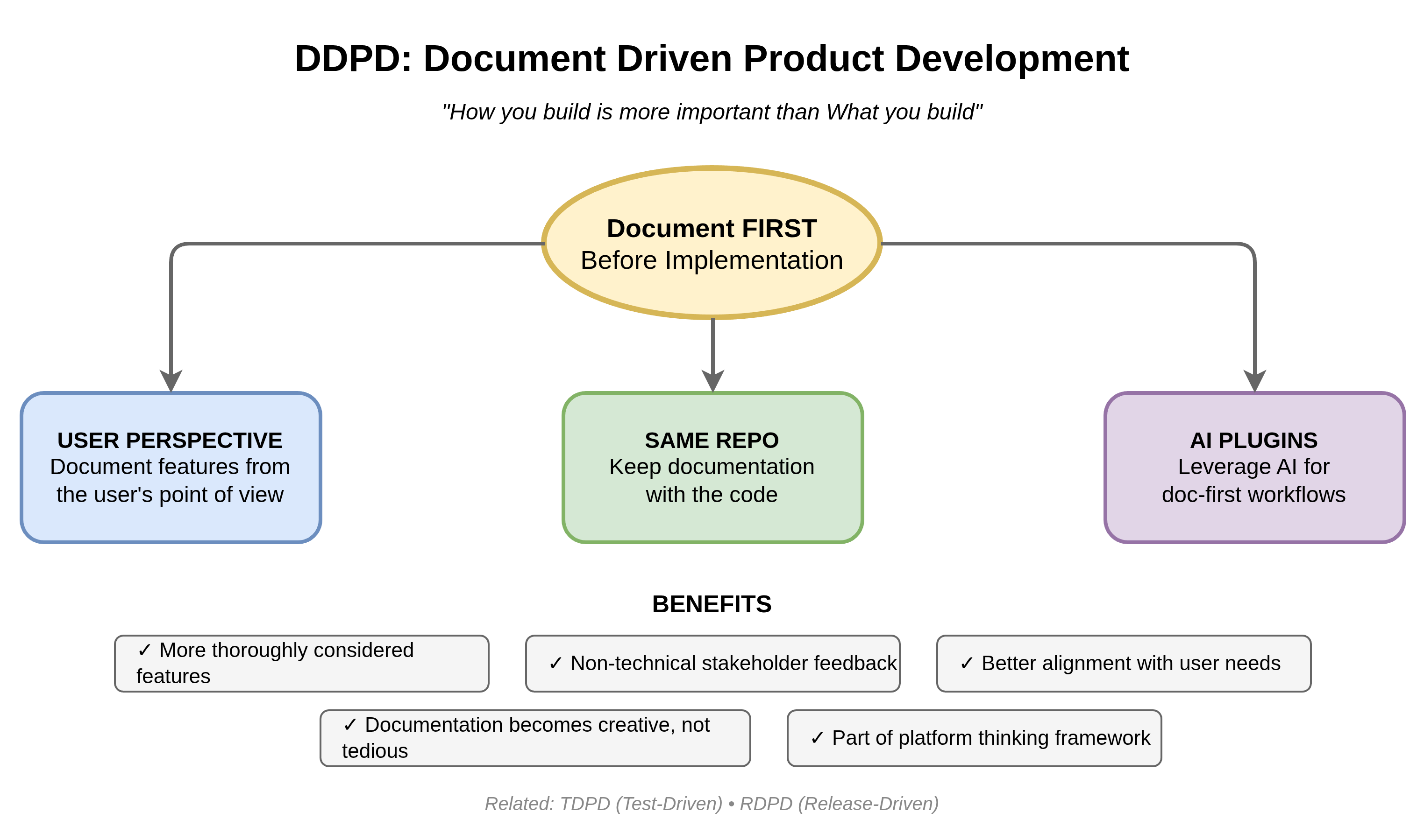

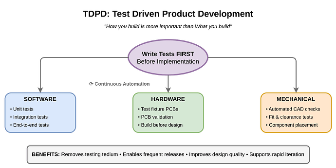

can you create a diagram for this post? 🧪 TDPD - Test Driven Product Development | Platform Thinking
📝 DDPD - Document Driven Product Development | Platform Thinking
