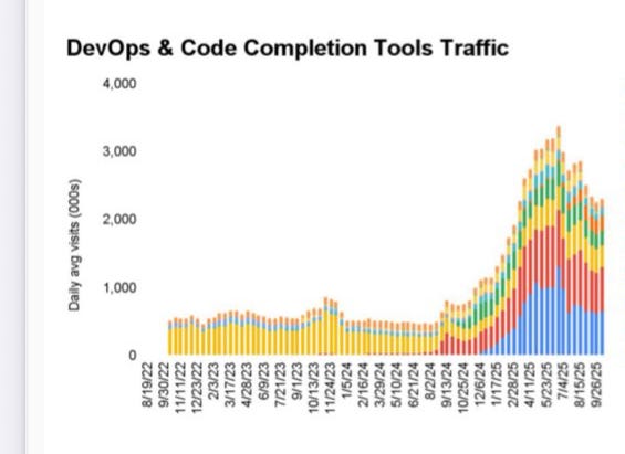

This article includes numerous quotes from industry; it appears there was an inflection point in late 2025 with AI coding.
