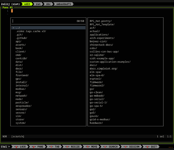

now that we use zellij we can do the same with
C-l = ":sh zellij run -f -x 10% -y 10% --width 80% --height 80% -- lazygit"
I also am interested in
Great idea – I modified slightly:
C-l = ":sh zellij run -f -x 5% -y 5% --width 90% --height 90% -- bash -c \"lazygit && zellij action close-
pane\""
maybe use sh instead of bash

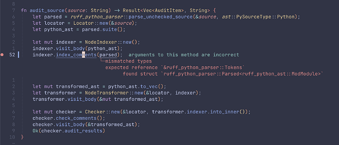

A few features that stand out:

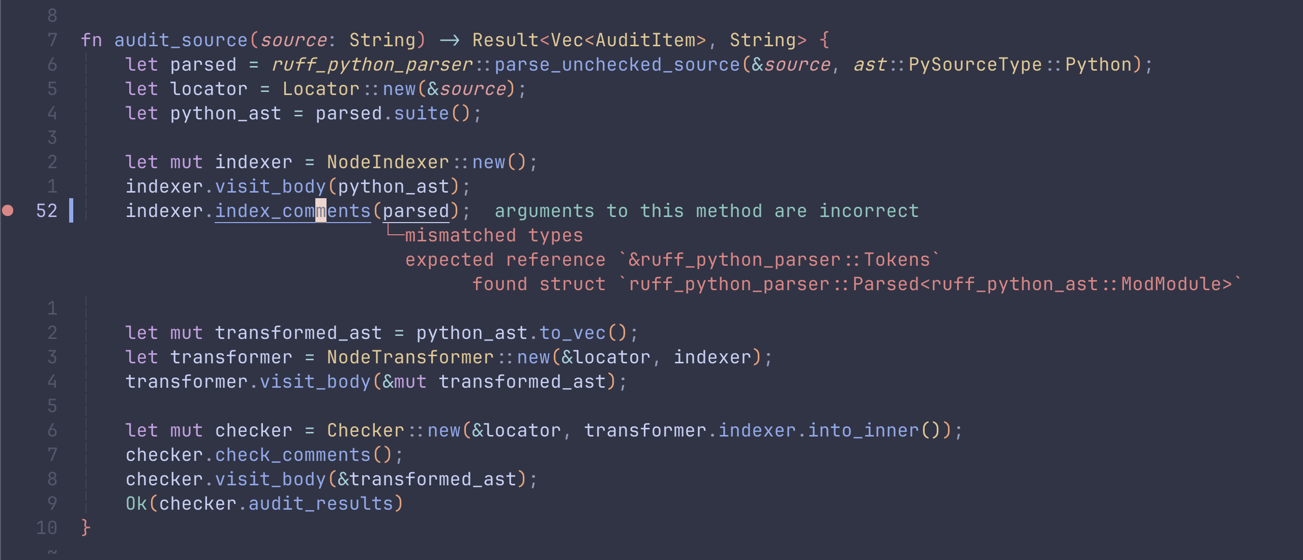

Inline diagnostics
Add the following to ~/.config/helix/config.toml
[editor.inline-diagnostics]
# Minimum severity to show a diagnostic on the primary cursor's line.
# Note that `cursor-line` diagnostics are hidden in insert mode.
cursor-line = "error"
# Minimum severity to show a diagnostic on other lines:
other-lines = "error"
And you get nice inline diags like:

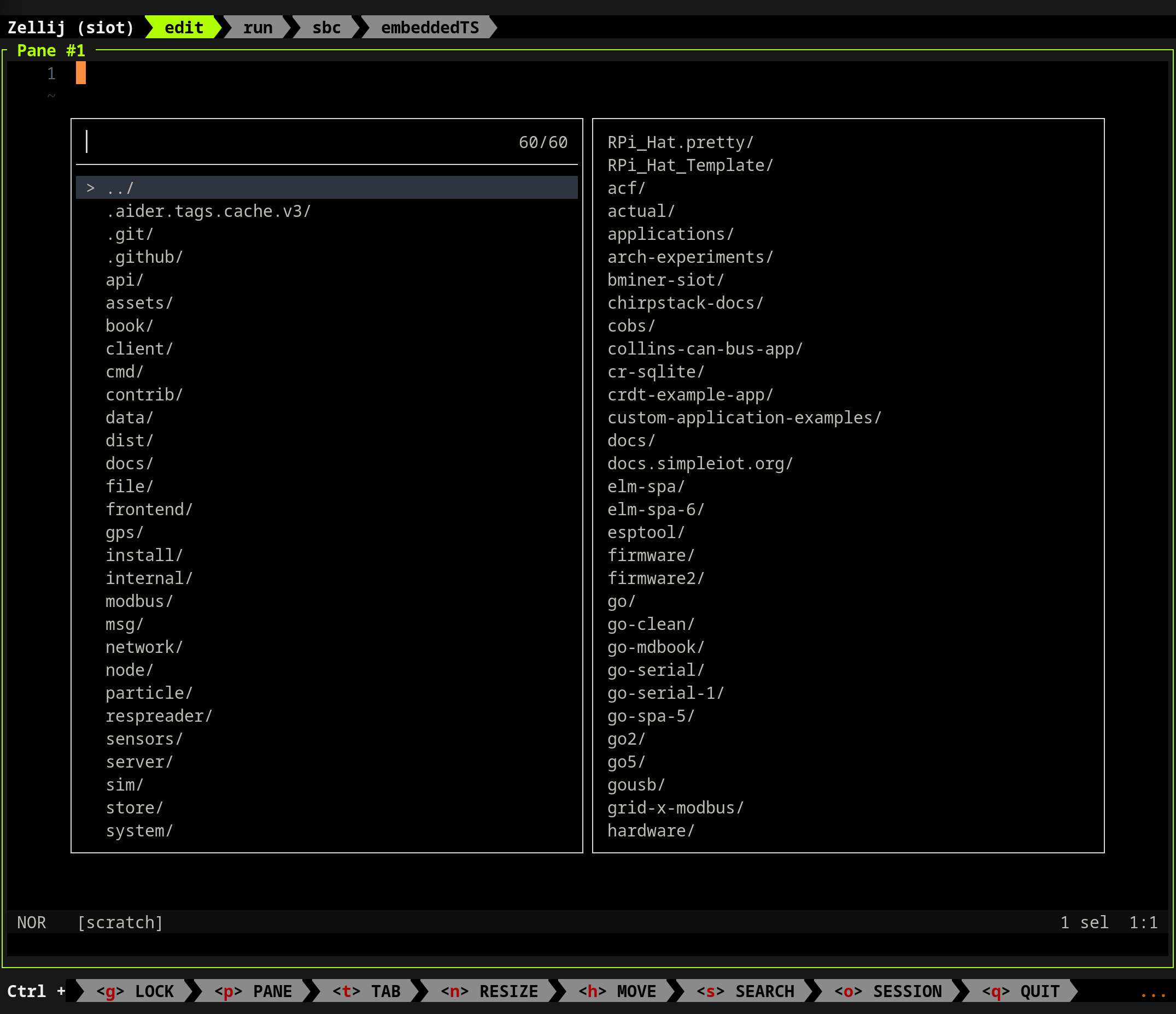

Picker columns
Some pickers now have columns, such as the symbol picker as shown below:
You can filter on the kind column by: %kind method

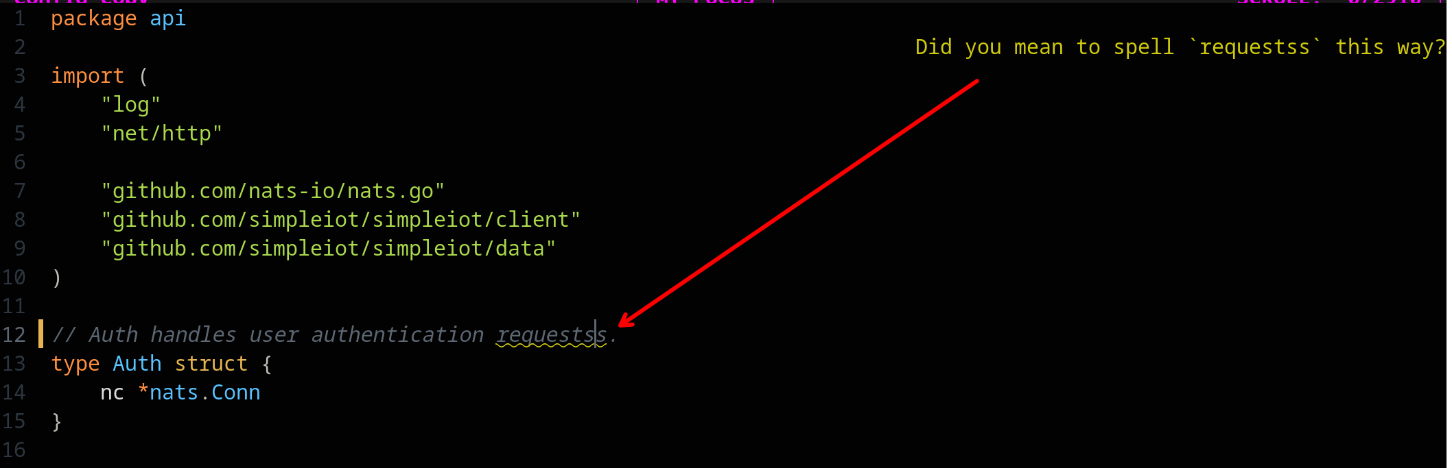

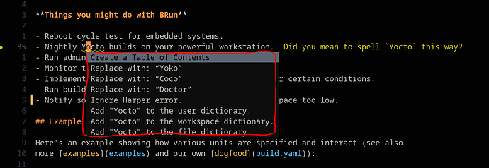

Harper for spell/grammar checking
Another big win is harper-ls integration:
[language-server.harper]
command = "harper-ls"
args = ["--stdio"]
[language-server.harper-ls.config.harper-ls.linters]
SpellCheck = true
SpelledNumbers = true
AnA = true
SentenceCapitalization = true
UnclosedQuotes = true
WrongQuotes = true
LongSentences = true
RepeatedWords = true
Spaces = true
Matcher = true
CorrectNumberSuffix = true
[[language]]
name = "markdown"
auto-format = true
formatter = {command = "prettier", args = ["--parser", "markdown"]}
language-servers = ["marksman", "harper"]
[[language]]
name = "go"
auto-format = true
formatter = {command = "goimports"}
language-servers = ["gopls", "golangci-lint-lsp", "gpt", "harper"]
Note, you can also add Harper for programming languages, and it will check comments.

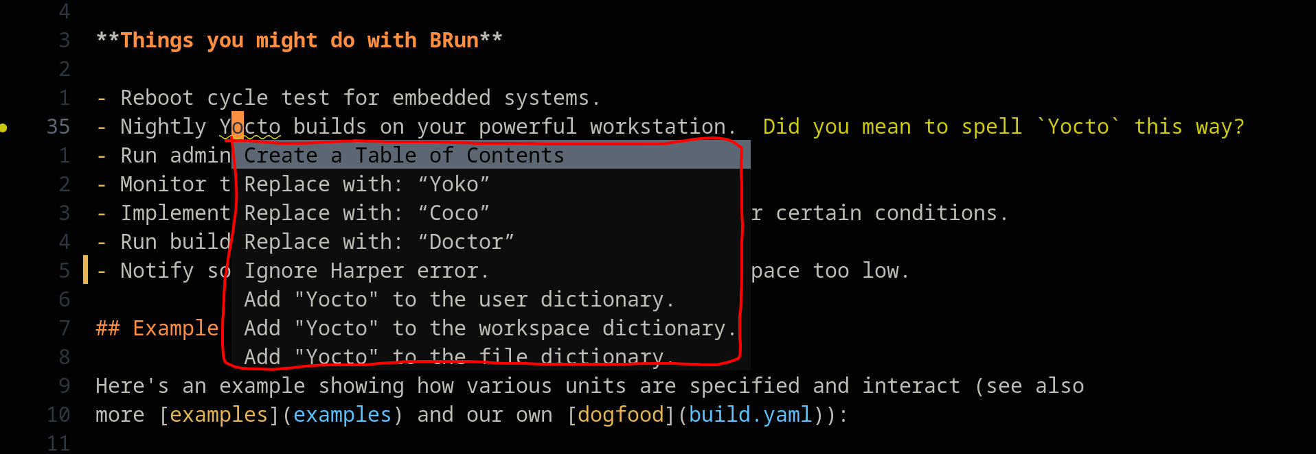

Harper quick actions for spelling correction/ignore
Space + a brings up LSP quick actions. This is how you replace a mispelled word or add to a dictionary. It is nice that you can specify a workspace dictionary – then it travels with the repo and everyone using Harper can benefit.
